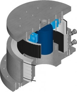

Torque motors are a special class of brushless permanent-magnet synchronous motors. Since the payload is directly connected to the rotor without the use of transmission elements, torque motors are classified as direct drives.
Depending on your perspective, a torque motor is either a rolled-up linear motor or a classic servo drive with a large number of poles. It is the large number of poles that enables conventional torque motors to attain high torque at moderate speeds. Another attractive feature is their compact design, which includes a narrow lamination stack and a large hollow shaft or bore.
As with linear motors, torque motors are a type of “frameless” motor. This means that the motor does not include a housing, bearings or feedback device. These components can be selected by the machine builder and optimized according to the required performance or purchased as part of an assembly.
