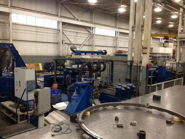

…that two HEIDENHAIN controls are an integral part of an unusual deep-hole gun drill machine now in place at Dieffenbacher North America hydraulic press manufacturer. This deep-hole drilling machine has three spindles that can operate simultaneously over a 12000 mm table, enabling not only the manufacture of deep holes up to 2500 mm in very large press plates but to also machine the necessary pockets all at the same time.
"These press heating/cooling plates are used all over the world," explained Nick Lupulescu, the Dieffenbacher North America plant manager in Windsor, Ontario, who added that their design of this large deep hole drill machine began in 2005. "The ability to mill pockets and slots, and simultaneously drill with three spindles at the same time provides us much efficiency."

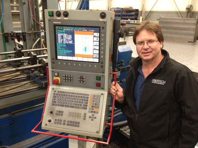

In order to set up the control of these spindles, area machine retrofitter Cybertech in Windsor, Ontario was called in during the final stages of machine development. "Our integration included two HEIDENHAIN controls – the iTNC 530 and the TNC 320," explained Dave Allen, owner of Cybertech who added that the TNC 320 controls the process used to mill the pockets in the press plates as the machine is drilling deep holes via the use of the iTNC 530. "To do this, we set up overrides for each of the three spindles and connected the two controls via an RS232 interface to basically fool the machine into operating all simultaneously. We really had to do some very complicated PLC programming to make this happen.
"This gun drill is programmed so that, if chosen, when the whole plate moves, that movement is transmitted to the TNC 320 and does an automatic offset," said Allen.
The integrators at Cybertech chose to recommend and use HEIDENHAIN for this job. "I like HEIDENHAIN because they are a very good retrofit control, easy to program," said Allen. "It was important that this complex job for Dieffenbacher be successful, and these simple-to-program controls facilitated that happening."

Nick Lupulescu with the Dieffenbacher deep-hole gun drilling machine
Dave Allen of Cybertech likes the HEIDENHAIN iTNC 530
