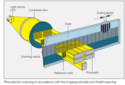

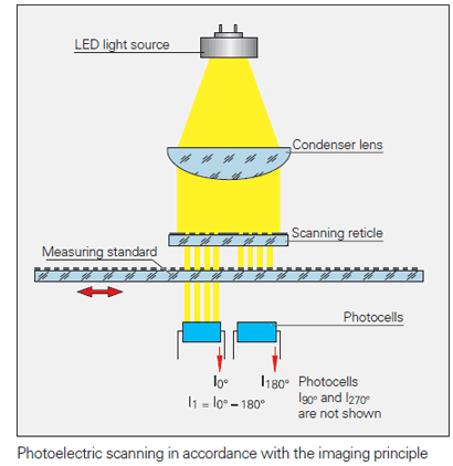

Like most HEIDENHAIN encoders, the linear encoders operate according to the principle of photoelectrically scanning a regularly structured measuring standard. In the imaging scanning principle, as it is used for example in the LS sealed linear encoders, a structured scale moves relative to an opposed grating—the index grating—with an identical or similar structure. The incident light is modulated: if the gaps are aligned, light passes through. If the lines of one grating coincide with the gaps of the other, no light passes through. Photovoltaic cells convert these variations in light intensity into electrical signals.

The scanning reticle has scanning fields whose gratings are offset to one another by one fourth of a grating period each. The corresponding photovoltaic cells generate sinusoidal signals, phase-shifted to one another by 90° (elec.). These scanning signals are not at fi rst symmetrical about the zero line. For this reason the photovoltaic cells are connected in a push-pull circuit, producing two output signals I1 and I2 in symmetry with respect to the zero line and electrically phase-shifted by 90°.

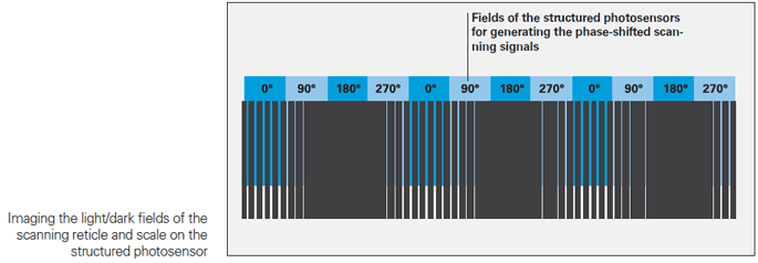

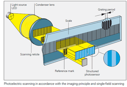

The scanning reticle has one large-area grating whose grating period differs slightly from that of the scale. This generates an optical beat along the length of the scanning fi eld: at some positions the lines coincide and let the light through. At other locations the lines and gaps coincide, causing a shadow. In between, the gaps are only partially covered. This causes a type of optical filtering that allows homogeneous signals of a shape very close to a sine wave. Instead of individual photovoltaic cells, one large-area, specially structured photosensor generates the four 90° electrically phase-shifted scanning signals.

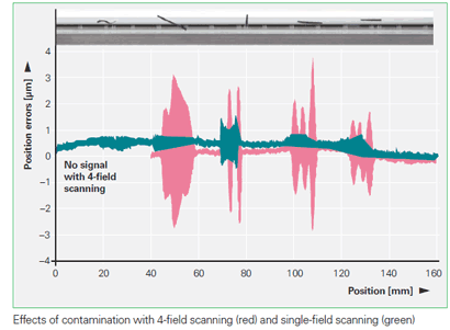

The large scanning area over the entire width of the scale grating and the arrangement of several scanning fields in succession make the encoders with single-field scanning extremely insensitive to contamination. The results of corresponding contamination tests prove this: even when contamination over large areas is simulated, the encoder continues to provide high-quality signals. The position error remains far below the value specifi ed for the accuracy grade of the encoder.
In many cases, depending on the contamination, this can even prevent encoder failure where 4-field scanning cannot.

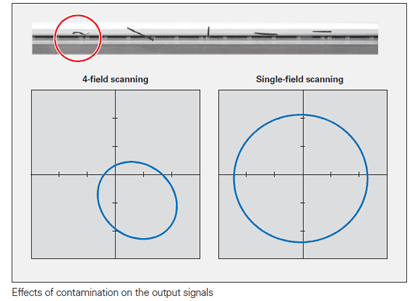

This example shows the influence of contamination on the output signals.

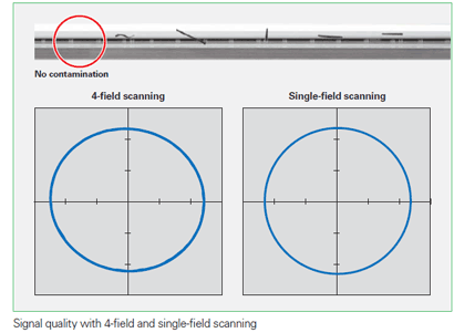

In the XY representation on an oscilloscope the signals form a Lissajous figure. Ideal output signals appear as a concentric inner circle. Deviations in the circular form and position are caused by position error within one signal period (see Measuring Accuracy) and therefore go directly into the result of measurement. The size of the circle, which corresponds with the amplitude of the output signal, can vary within certain limits without influencing the measuring accuracy.
In the encoder with single-field scanning, however, one sees only a small change in the amplitudes. In the XY display, only the diameter changes slightly—a sure sign of very low position error. This type of contamination has very striking effects with 4-field scanning: Because two scanning fields are involved, the XY display shows an extremely eccentric ellipse. This causes a total failure of the encoder at this position.

The single-field scanning method has considerable influence here: The large scanning field and the special optical filtering generate scanning signals with high constancy and good sinusoidal form over the entire path of traverse. This substantially reduces position error within the signal period. This is very visible on the XY display of the oscilloscope: The output signals of the linear encoders with single-field scanning show a more circular form and less signal noise.
