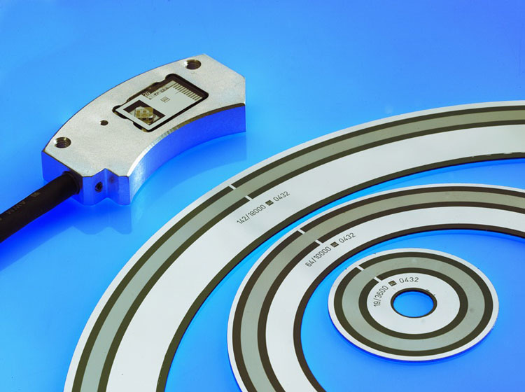

NUMERIK JENA's non-magnetic LIK linear series has a 20-micron graduation on glass and digital versions can output resolutions to 50 nanometers, where the digitizing electronics reside in the connector. With loose mounting tolerances of the scanning unit in relation to the 20 micron scale, and three configurations of mounting the scanning unit, the LIK series provides excellent motion feedback for high magnetic environments.
The RIK rotary series is a kit style bearingless rotary encoder including a disk with various diameters and line counts, and non-magnetic scanning units to match those diameters. The various sized aluminum disks containing a 20-micron graduation are to be epoxied to the customer's hub design. NUMERIK JENA can also adhere the disks to your custom hub designs at the factory with your exact specifications and lowest runout errors.
Both encoder systems use the Epiflex Adjustment Tool to enhance the signal margin during installation on the machine. Long cable extensions are also possible for high magnetic field environments.
