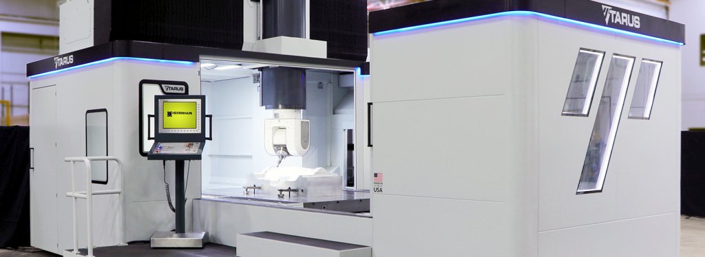

TARUS TBM5 Gantry equipped with TNC 640, HEIDENHAIN glass scales and ETEL torque motor/direct drive ballnuts

TARUS’ MM5 high-speed 5-axis CNC machine is for milling clay models of automobiles in design studios. The first TARUS machines equipped with TNC 640 (pictured here) were MM5 machines installed at Geely Design Studio in Gothenburg, Sweden. The large direct rotary tables are equipped with ETEL torque motors. A similarly equipped MM5 was recently installed at Navistar in Lisle, IL.
