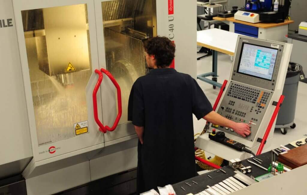

Now using eleven five-axis HERMLE milling machines that are coupled with HEIDENHAIN’s TNC controls, Marten’s facility produces parts around the clock for many industries, including medical, aerospace and precision tools to name a few. Serving as a source for many companies that don’t have the time or resources to design and produce parts themselves, some complex, Marten is assuming that role for many.

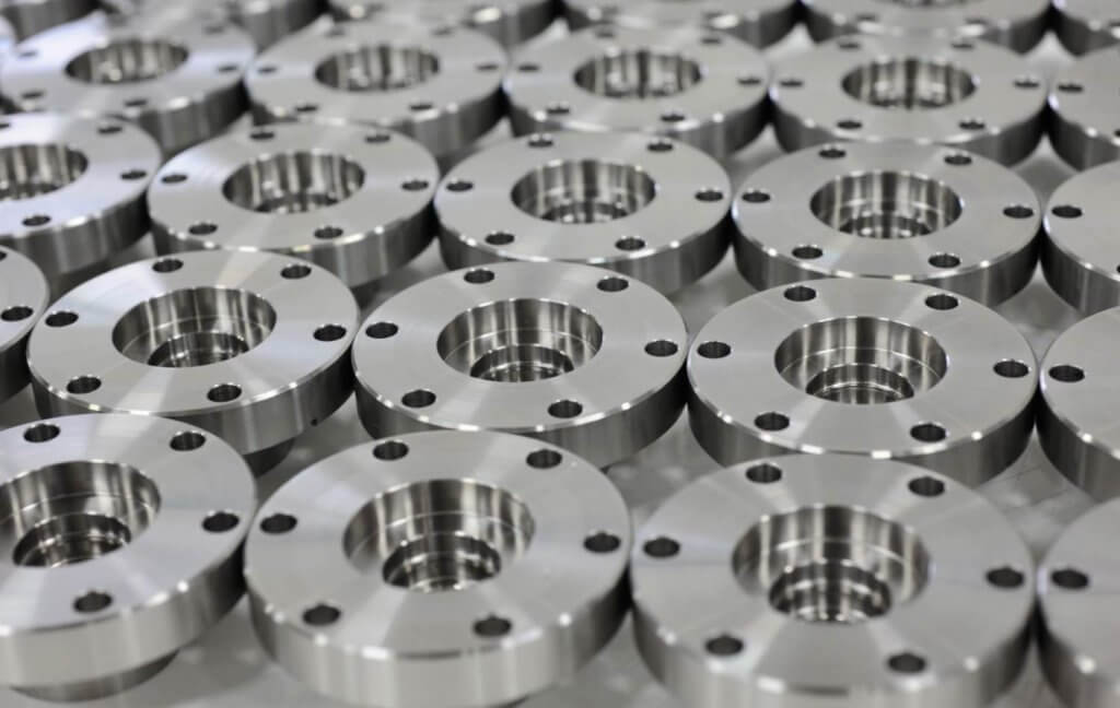

“What has driven our growth even from the beginning is our ongoing commitment to invest in resources to produce specialty high tolerance parts,” explained Marten.

“These machines are just easy to understand and use,” said Marten. “The HEIDENHAIN control has a whole keyboard right on it, and has a lot of ergonomic and visual prompts. Creature comforts that our operators like, and are helping to make us successful.

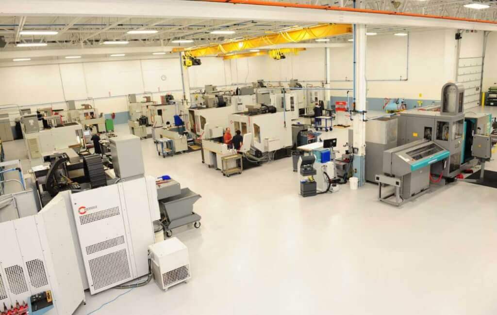

Continuing to grow and invest in similar equipment, Marten now has many HERMLE/HEIDENHAIN machine workhorses with pallet automation on site, as well as some additional finishing/specialty machines such as CMMs. “We have three more five-axis HERMLE machine on order now, and these will all have the newest HEIDENHAIN TNC 640 control on board with even more capabilities,” added Marten.

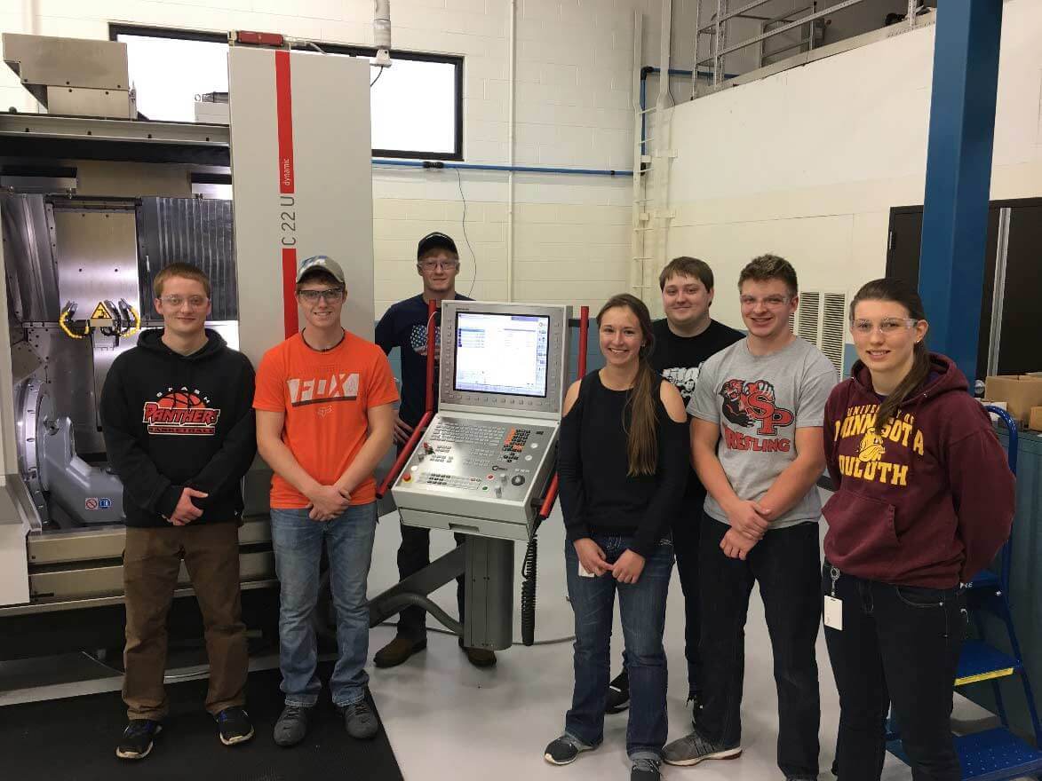

The fourth annual Heavy Metal Tour was held in central Wisconsin this past October where over 100 sixth and seventh graders were bussed to various manufacturing facilities to see them in action. At Marten, besides the annual cutting demonstration at a manual lathe given by Marten founder Alan, control stations are set up where CNC instruction and programming experiments can be done.
“In one area, we lay out a coordinate system to make a 2D part profile. Then the students put those coordinates in the control and run the program to make a part,” said Marten. “We also do a sample job using aluminum with a high-feed tool path on one of our newest machines, the HERMLE C22 with a HEIDENHAIN iTNC 530 control. The kids really get a kick out of it because it moves fast, chips are flying and it’s making a lot noise, while at the end, they end up with a flawless finished part!”
