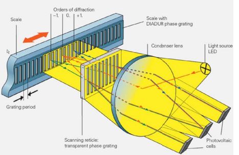

Figure 2: Interferential measuring principle
Stable measuring standards normally have a defined thermal behavior and are independent of air pressure fluctuations. In recent years, the LIP, LIF and PP product families from HEIDENHAIN have established themselves as stable measuring standards. The interferential scanning principle behind them exploits the diffraction and interference of light on a fine graduation to produce signals used to measure displacement that are therefore insensitive to air fluctuations. A relative motion of the scanning reticle to the scale causes the diffracted wave fronts to undergo a phase shift: when the grating moves by one period, the wave front of the first order is displaced by one wavelength in the positive direction, and the wavelength of diffraction order –1 is displaced by one wavelength in the negative direction. Since the two waves interfere with each other when exiting the grating, the waves are shifted relative to each other by two wavelengths. This arrangement results in two signal periods from the relative motion of just one grating period. Interferential encoders function with grating periods of, for example, 8 µm, 4 µm and finer. Their scanning signals are largely free of harmonics and can be highly interpolated. These encoders are therefore especially suited for high resolution and high accuracy and a very high inherent repeatability. Even so, their generous mounting tolerances permit installation in a wide range of applications.

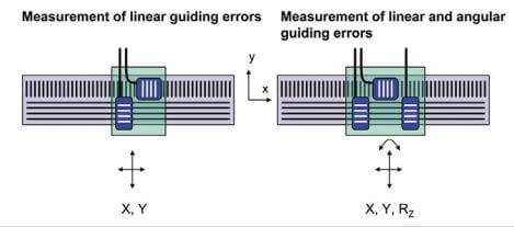

Besides the usual longitudinal track (x axis) with the interferential graduation of the familiar LIF (4 µm signal period), the LIF 481 1Dplus features an additional y axis track perpendicular to it. This nevertheless does not require eliminating of the reference mark on the longitudinal track. As is usual at HEIDENHAIN, the absolute position on the scale, established by the reference mark, is gated with exactly one measuring step
The glass ceramic ZERODUR® is used in a graduation carrier whose expansion coefficient of 0+/- 0.1 x 10-6 K-1 is exact over a large temperature range and is characterized by high resistance to aging. With the appropriate arrangement of two or three scanning heads (Figure 5) the LIF 481 1Dplus linear encoder makes it possible to measure and compensate linear and angular guiding error or the inuences of thermal expansion:

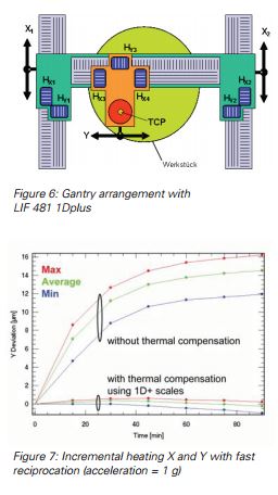

Recording the “real-time condition” and compensation of the actual measured values contribute significantly to the improvement of positioning accuracy in the nanometer range. These ambitious expectations of the encoder were confirmed with the impressive results of an experiment.
Figure 5: Arrangement with 2 or 3 scanning heads
NanoRange6Test setup
Figure 6 shows an example of the user of 1Dplus scales on a gantry-type milling machine. The x axis is equipped with two heads HX1, HX2 in an example arrangement of the scales. If the tool center point (TCP) is also aligned in Z to the centers of rotation HX1 and HX2, all Abbe offsets of the X axis are equal to zero. The heads HY1 and HY2 detect straightness error (y) of the X guideway axis and, to an extent, the inuences of thermal expansion. On the Y axis the heads HX3 and HX4 can be used for compensation of straightness errors in the X axis and Abbe error in the X axis.
