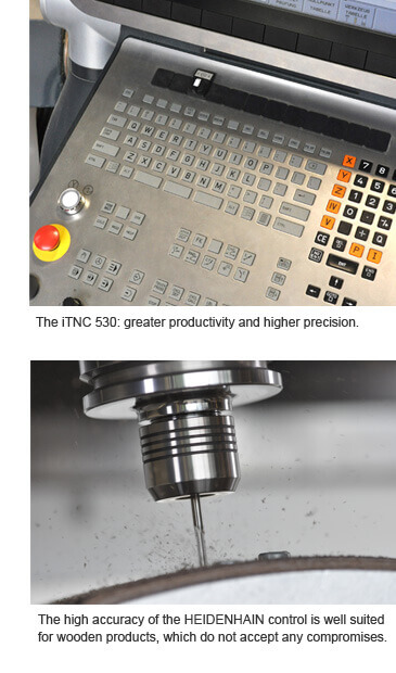

The iTNC 530 machines exotic wood
The unique machines did their job well. But the time-consuming manual steps got in the way of the growing unit numbers. What could be done? The decision was quickly made to find a powerful NC solution that was suited for the precise machining of exotic woods.
Thomas Dobler from Deckel Maho immediately became excited about the unusual request, and presented several interesting proposals to the young entrepreneurs. In the end, a DMU 40 mono BLOCK with HEIDENHAIN iTNC 530 got the nod to manufacture the high-quality products.
This was a good decision! Nobody in the Rolf Spectacle team had any idea about 5-axis machining, not to mention CNC programming. But as pragmatically and enthusiastically as they approached everything else, Martin Iljazovic delved into the subject. The workshop-oriented programming in the HEIDENHAIN plain-language format made it easy. Now he navigates through the program with ease, and praises the structure function with which he quickly finds his way in long programs.
But of course it is somewhat unusual that the machine tool is being used here, since after all the wooden structures being machined are very delicate. Isn’t that like cracking a nut with a sledgehammer? Martin Iljazovic is convinced that they made exactly the right decision: “We must work very precisely, particularly on the high-quality hinge. We can optimize use of the machine regarding capacity and machining speed, and the previously complex handling with various fixtures is now covered by just one setup.”

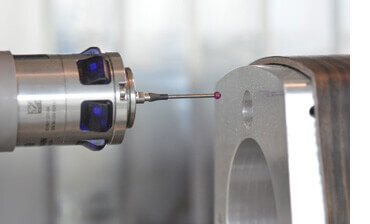

One intention of the automated machining is to completely remove humans as a source of error. Before machining begins, the iTNC 530 uses a HEIDENHAIN touch probe and the appropriate cycles to check the correct position and orientation of the blanks, which are manually placed on a suction fixture. This idea also shows these youngsters’ creativity: the flexible wooden blanks are held in place in the fixture by means of lower air pressure. This way the wood sits in an exactly defined position, which is a prerequisite for precise machining.
Having the automated tool measurement detect which model is to be machined was also a great idea: only a single program is needed for the around 30 different models of eyeglasses. The HEIDENHAIN touch probe simply measures the distance to a defined hole on the fixture being used, and the control then automatically selects the correct machining program.

The glasses frames are milled from the workpiece blanks using 5-axis machining. Since very short tools are used for the cutting of the fine structures, dangerously close encounters can occur in the machine’s work envelope. Therefore, Rolf Spectacles makes sure to use the all-encompassing dynamic collision monitoring (DCM option) of the iTNC for certain positioning movements.
The delicate wood also presents the machine tool with another challenge: The cutters being used have very small radii, and no cutting data for this atypical material can be found. For this reason, and to increase reliability of the production process, the tools are constantly monitored for breakage.
Another disruptive factor is the fine wood dust, which can impair the machine’s functions. Rolf Spectacles has modified all of its machines, and in this case the DMU 40 from Deckel Maho was equipped with a suction bell, which artfully solved this problem.
