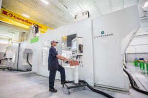

As ServiceMold President Martin Schuurman explains, “In 2006, we purchased our first 5-axis machine, a Zimmermann with a HEIDENHAIN iTNC 530. The path control and contour fidelity of HEIDENHAIN controls is superb and masterfully addresses the conflict between fast, smooth and accurate. The acquisition gave us the ability and capability to explore entering the aerospace market. After a number of calls and quotations, we scored a small order from a major Tier 1.” Sales began to grow, some years by more than 25%, Schuurman says proudly. By 2013, there were four additional Zimmermann machines on the floor and the existing facility had filled nearly to capacity.

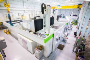

ServiceMold utilizes the Zimmermann and other machining centers to produce molds and components from various alloys of aluminum, steel, Invar and stainless. The twin facilities house boring mills with rotary tables, gundrills, CNC milling machines, 3-axis high-speed mills and, the core of the company’s machining firepower, seven Zimmermann and two Parpas Diamond 5-axis high-speed machining centers, also with HEIDENHAIN TNC controls. At the high end of the Zimmermann lineup are machines with the company’s unique portal milling head, plus an FZ33 Compact, which allows large aluminum and composite structures to be machined without moving them, as the workpiece rests on a fixed table, while the rigid portal travels in the x-direction. The moving bridge on the machine comprises a rigid portal, cross- and z-slides plus the milling head.
Additional Zimmermann machines on the floor at ServiceMold include three FZ37 5-axis portal milling machines and three FZ30 open table 5-axis portal milling machines, ideal for the one-off and short run work done so often at ServiceMold.

As Schuurman points out, a key to the flexible nature of his company is the fully programmable capabilities of the Zimmermann machines and HEIDENHAIN controls. Especially with the new TNC 640 which has color-coded NC code, the smart.Select option and a comprehensive help menu make programming much easier. The graphics in the simulation mode have been enhanced and can now show the tool path with code numbers and in different colors for different machining steps. A new on-board cutting data calculator lets the operator do the most basic feed rate (per teeth, contour feed rate) calculations right at the machine.
