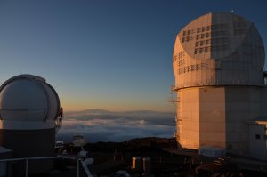

![](https://www.heidenhain.us/wp-content/uploads/2022/06/1584821151829.original.de_.1586174136000-web.-768x509-1-300x199.jpg)
The DKIST solar telescope is being completed at an altitude of over 3000 m atop Haleakalā, the highest mountain on the Hawaiian island of Maui (photo: Dr. Michael Sigwarth, KIS).

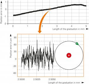

![](https://www.heidenhain.us/wp-content/uploads/2022/06/1584821152046.original.de_.1592372892000.-300x283-1.jpg)
Accuracy of the graduation relative to the size of a hydrogen atom: the accuracy over a traversing distance of 5 µm is critical.
Accurate selection of a wavelength requires highly accurate and perfectly parallel positioning of the two plates. But researches don’t want to study only one wavelength all of the time. Much more interesting are the changes between the different wavelengths, which is why the plates are continuously in motion.
Accuracy down to atomic dimensions
What seems so simple on paper demands maximum performance from the measuring system to be used. In order to repeatedly obtain the required positioning accuracy for each step, measuring steps of 20 pm are required. In addition, the measurement errors must not exceed a total of 100 pm over the course of an hour. Dimensions on this scale are equivalent to the diameters of atoms. By way of comparison: 120 pm is the commonly stated size of a hydrogen atom.
“The crux of the whole setup is the distance measurement,” confirms Dipl. Ing. (FH) Clemens Halbgewachs from the KIS, explaining: “We initially determined the position of the upper plate with only three linear encoders. Unfortunately, we weren’t satisfied at all with the accuracy. So we searched for and found the causes. A temperature deviation of just one hundredth of a single degree Celsius affects the position of the lower plate.” The solution is now a total of six HEIDENHAIN LIP 382 linear encoders featuring a standard scanning head and customized scale, with three encoders on the lower plate and three on the upper one.
