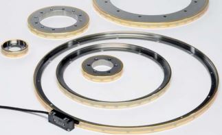

Figure 2: The ERA 4000 series modular angle encoders are supplied as two separate components: the scale drum and the scanning head
The ERA 4000 series modular angle encoders from HEIDENHAIN are supplied as separate components: the scale drum and the scanning head (Figure 2). They are characterized by their compact dimensions and the high quality of position information in connection with a high number of signal periods. A regular graduation structure that carries the position information is applied to the scale drums. Since an absolute reference is required to ascertain the positions, the scale drums are provided with an additional track that bears distance-coded reference marks. Because the reference marks are individually spaced according to a mathematical algorithm, the axis need only rotate by a small angle for the scanning unit to cross two successive reference marks and thereby ascertain the absolute position.
For Ullrich Gäbel, “One of the outstanding benefits of the modular design is that the scale drum can be placed very close to the bearing. The advantage is that the closer the scale drum is located to the bearing, the less the effect of error from any tilting in the bearing. The result is that the measuring accuracy is hardly influenced.” The rigidity of the bearing therefore has an immediate influence on measuring accuracy. The more rigid the bearing, the more accurate the measurement can become.
To attain the high accuracy grades of the angle encoders, special methods were developed of applying the graduation structure to the drum. The realized graduation with high homogeneity and edge definition as well as single field scanning with the optical filter structure enables consistently high signal quality of the output signals over the entire circumference of the drum. The subdivision accuracy values are therefore significantly better than ± 1 % of the signal period. Although signal interpolations of up to 4096 are usual, thanks to the high signal quality of these encoders, the servo controllers in the grinding machine for manufacturing optical lenses can be operated with 16 384-fold interpolation and with 24 000 lines on the encoder. Schüssler adjusts the scale drum to a concentricity of 0.5 µm using and ND 287 digital readout, which is also made by HEIDENHAIN. “This enables us to align the scale drum to approximately the graduation accuracy of the encoder. This wouldn’t be possible with a dial gauge,” says Ullrich Gäbel.
