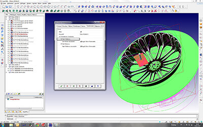

Scribbles and technical drawings are used to integrate the customer’s ideas into the concept phase. Thunderbike places its trust in hyperCAD® and hyperMILL® for CAD/CAM implementation, and has created a sector-pioneering process chain that includes machines equipped with HEIDENHAIN controls. All components are modeled and constructed in the CAD system and receive their harmonious look during this phase, with the complete project expanding in a virtual kit of components where appearance, fitting accuracy and assembly capability are ideally matched and assessed.
hyperCAD® is simultaneously used in supplementary areas for machining and vendor parts. “With hyperCAD® we’re simply more flexible, especially with free-formed surfaces when nearing actual production,” said Herbert Niehues, responsible for the planning and production of components. Graphic simulation of the machining cycles is highly important, because with turning/milling using 5-axis technology the DCM (dynamic collision monitoring) function provides the necessary safety to run the planned cycles on the machine. The ideal interplay between the CAM system and the HEIDENHAIN TNC 640 control is the result of a close cooperation between both manufacturers. “Precision of the faces is very high because the new control and themachine are able to implement the tighter points defined in the CAM system.”

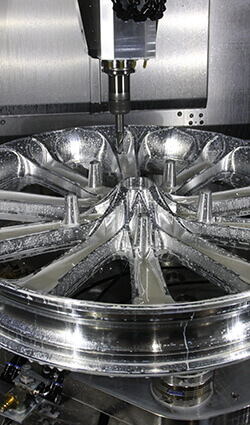

The result can really be seen. An ideal example are the newly designed wheels of the Unbreakable – a 26” diameter at the front and 21” at the back, with their inner free-form areas being reminiscent of turbine blades. These aesthetic highlights are initially machined on the new turningmilling center from an aluminum block at a maximum speed of 800 rpm. The contours are then produced with 5-axis simultaneous milling. “For us this means less rechucking as well as shorter equipping and idle times,” said Herbert Niehues. The previous six work cycles on three different machines were reduced to just three work cycles on the turning-milling center.
Following initial milling, the wheels are anodized by an external company, then fixed on the machine again for milling the outer edges and creating the metallic contrast to the matte coating. The TNC 640 once again provides the right strategy for this task—with 5-axis contour milling the tool is always inclined at the same angle to the face, ensuring that the width of the milling path remains constant.
