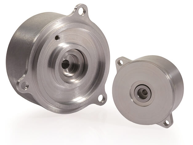

FIGURE 1: Outstandingly well suited for highly dynamic, energy-efficient servo drives: the ECI/EQI 1100 inductive rotary encoders with 37 mm diameter (at right) and ECI/EQI 1300 with 65 mm diameter (at left)
Whether small, large, singleturn or multiturn, whether with or without integral bearing: the rotary encoder program from HEIDENHAIN offers the right solution for any task. Of particular interest are the current series of inductive rotary encoders ECI/EQI 1100 and ECI/EQI 1300.
With respect to their predecessors, the ECI/EQI 1100 and ECI/EQI 1300 inductive rotary encoders without bearings (Figure 1) offer distinctly improved control quality and system accuracy. Also, they are strongly resistant to vibration. They are available in typical sizes with diameters of 37 mm (ECI/EQI 1100) and 65 mm (ECI/EQI 1300). HEIDENHAIN was able to realize them thanks to a newly developed ASIC.

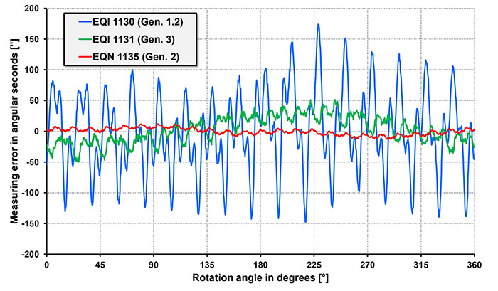

FIGURE 2: Typical accuracy curves of inductive and optical rotary encoders over one revolution (using the EQI 1100 with 37 mm diameter as example)
Accurate and dynamic
The system accuracy is a critical criterion for assessing suitability for specific applications. Figure 2 shows the recorded accuracy curve in a comparison of multiturn rotary encoders with diameters of 37 mm. Compared with the previous model, the new EQI 1131 inductive rotary encoder has greatly reduced short-range measurement errors. As expected, the EQN 1135 optically scanned encoder offers the highest accuracy. The accuracy curves are comparable for the larger rotary encoders with 65° diameter.

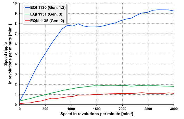

On a high-end servo motor, however, the encoder’s influence plays a decisive role for speed stability. Figure 3 shows the speed stability of a controlled motor at different speeds. As was already the case in the comparative test for system accuracy, multiturn rotary encoders with 37 mm diameter provide the control loop feedback. And as with the system accuracy, these results can also be transferred to the larger variants. Speed stability with the new inductive rotary encoders differs only slightly from that of optical devices. Thanks to their robust scanning and higher tolerance to vibration (stator: ≤400 m/s², rotor: ≤600 m/s²), they are ideal for production machines.
FIGURE 3: Speed stability of motors with inductive and optical rotary encoders (using the EQI 1100 with 37 mm diameter as example)
