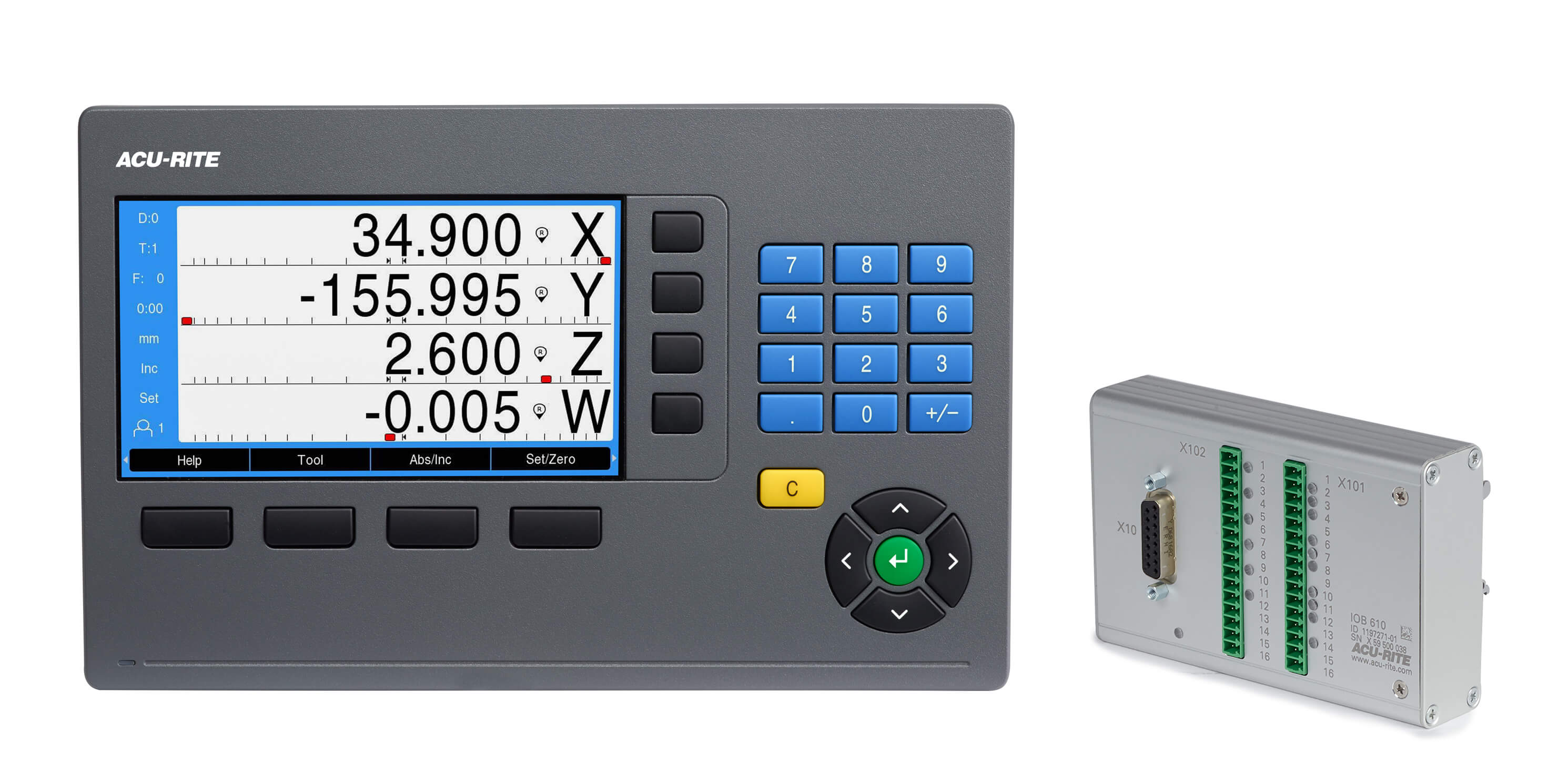

software SCHAUMBURG, IL (October 2019) – HEIDENHAIN CORPORATION’s Acu-Rite Solutions introduces new software for its versatile 300 Series digital readout (DRO) that now allows users to control a sinker EDM machine. This new development broadens this established DRO’s use to include all of the most common manual shop machines such as milling, turning, grinding and now EDM in a single DRO.
When Acu-Rite Solutions’ new EDM software is loaded into a DRO300 and coupled with an IOB 610 interface box, it enables the simple control of sinker EDM through the use of three relay signals. This software is now included on all new multipurpose DRO300s. For those who already own an Acu-Rite Solutions DRO300, v1.3.1 can be downloaded for free on the Software Updates page of acu-ritesolutions.com.
Some key new features of the Acu-Rite Solutions DRO300 for EDM control are:
  • Automatic Depth Programming: The EDM machine’s ram can be configured to automatically retract or dwell at the target depth.
  • Dwell Cycle: The relay holds the Z depth until spark-out occurs or can control an orbiter cycle.
  • Reverse Fault Detection: This prevents creep out of the bath during a burn cycle.
  • EDM Display Mode: This shows the current ram depth, the maximum depth reached and the target depth simultaneously on the three-axis displays.
Acu-Rite Solutions is proud to now offer one DRO platform that is rugged and easy to use for all common manual machines.
Backed by a comprehensive warranty, HEIDENHAIN’s Acu-Rite Solutions systems are supported by a worldwide distribution network of trained and qualified personnel.
Acu-Rite Solutions is a brand of HEIDENHAIN consisting of digital readouts, linear scales and the MILLPWR G2 control. Acu-Rite Solutions DROs and control are manufactured in the U.S. acu-ritesolutions.com
