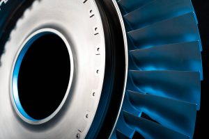

Typical DutchAero part: turbine wheel wheel for the nozzle of a jet engine
The Dutch enterprise DutchAero has been a renowned manufacturer of complex parts for the aircraft industry for 50 years. With support from the parent company KMWE, the production engineers developed a new measuring device for quality assurance that not only fulfills present tasks but is also equipped for the future. The core elements are 17 HEIDENHAIN-ACANTO touch probes and the modular MSE 1000 subsequent electronics.

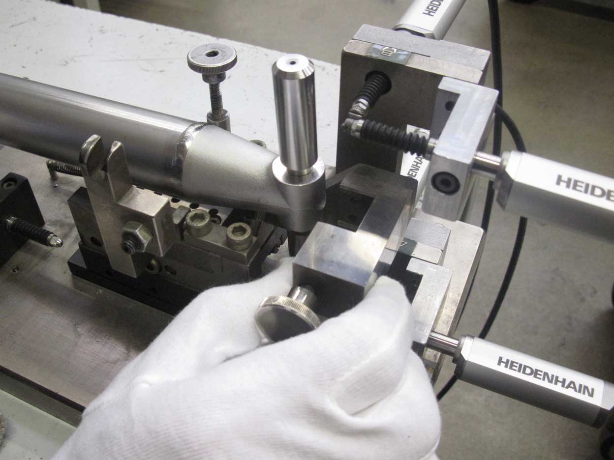

Accurately measured: one of the two new measuring devices with HEIDENHAIN-ACANTO touch probes at DutchAero
Ben Dekkers summarized the high demands plainly and simply: “The new measuring device should have at least the performance of its predecessor and also be equipped for new tasks. Apart from that, we wanted automatic acquisition of the measured values of the products to be inspected.” Extensive data acquisition is necessary to be able to monitor the measured quality. The colleagues at KMWE were responsible for this special task and developed and programmed the corresponding software.
The new measuring device, developed and manufactured in-house, essentially consists of 17 touch probes of the HEIDENHAIN-ACANTO series and modular MSE 1000 subsequent electronics. Ben Dekkers explains the setup: “The ACANTO touch probes measure two different high-tech aircraft parts manufactured in series by DutchAero for the no of a jet engine. The MSE 1000 acquires the measured values, produces a complete electronic report and provides easy process monitoring.” At present there are still nine touch probes responsible for one part and the other eight for the other part. In future, however, all 17 HEIDENHAIN-ACANTO touch probes are to be used simultaneously.
Everyone party to the project is very pleased with the result of their combined efforts. Ben Dekkers: “The touch probes in our measuring device work with an accuracy of ±2 µm. We do not need such a high level of accuracy yet, but it gives us a margin for the future.” The measuring device is already being used in production. In parallel, DutchAero is testing the repeatability and reproducibility of the complete setup—a very complicated procedure with extensive test series.

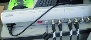

Data acquisition station for the 17 touch probes: the MSE 1000 subsequent electronics acquires the measured values, records them in full and monitors the processes.

In designing the MSE 1000, it was very important for HEIDENHAIN that installing the modules and connecting them to the measuring device were made as simple as possible. Modules can be mounted to DIN rails to achieve tidy and compact measuring stations. The selected system configuration of the modules is detected automatically and unnoticed by the user, who only needs to define the specific measuring channels.
Simple connection: the EnDat interface
When using EnDat encoders like the HEIDENHAIN-ACANTO touch probes you do not even need to configure the measuring device. It provides all the data required for operation itself and is immediately ready to measure. Of course, the MSE 1000 also enables EnDat encoders to be connected in their entire functionality, and this gives users decisive advantages in terms of the predictive maintenance of their measuring systems. The functional reserve of absolute and incremental tracks can also be depicted for example thanks to the online diagnosis functionality of EnDat devices. Users can also access other operational criteria such as illumination condition, signal amplitude and position value calculation, thus decisively optimizing the operational availability and safety of the system.
Apart from the HEIDENHAIN EnDat protocol for absolute encoders, the MSE 1000 also supports all standard incremental encoders. Furthermore, it provides other connection options for analog sensors like LVDT and HBT position sensors from renowned manufacturers. Modules with switching inputs and outputs enable interaction with other actuators in the encoder.
A DLL program library is included in delivery with the MSE 1000. This represents the range of features of the MSE 1000 on the software side and enables operators to develop their own testing programs. For testing processes that require additional actions depending on the measuring result, it is possible to connect more inputs and outputs. This programming capability of the MSE 1000 partly eliminates the need for additional control equipment.
