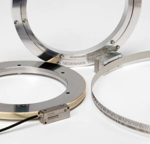

Significantly higher accuracy for robots
At the show, HEIDENHAIN will present the ECI 4000 absolute inductive rotary encoder for hollow shaft diameters of 180 mm. Not only is this encoder robust and accurate, but, as a modular system with a scale drum and a separate scanning unit, it also features ideal mounting characteristics for use in robots.
The ECI 4000 rotary encoder, as well as HEIDENHAIN’s ECA 4000 angle encoder and the WMRA from AMO, significantly improve the absolute position accuracy of the tool center point on industrial robots by up to 70% – 80%.
