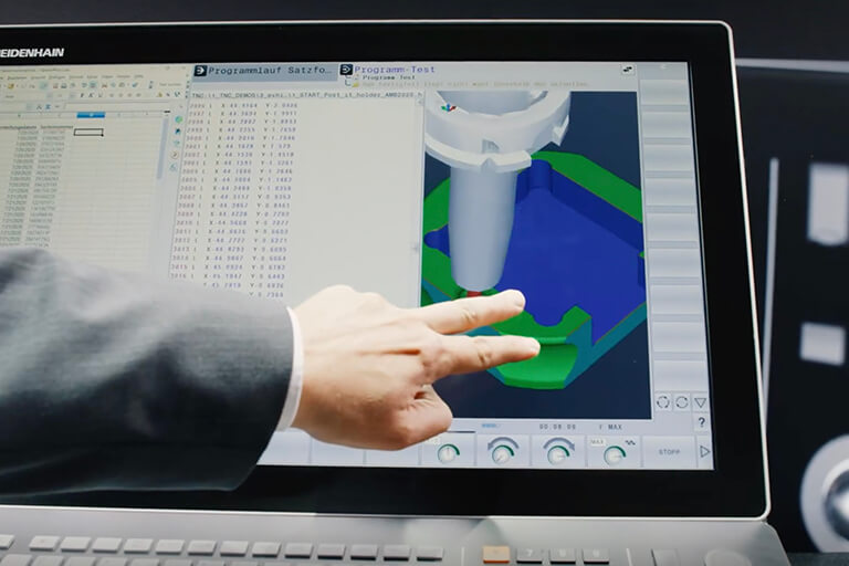

Spatial plane function![](https://www.heidenhain.us/wp-content/uploads/2021/08/hh-controls-mold-making-post-img2-300x200.jpg)
Many mold cores or bases require five-sided machining without excessive coordinated movements. The CNC should have a spatial plane function that allows the machinist to set the plane that is machined on each side of the part. That way, the machinist can program each side of the part in an X-Y-Z plane without changing the CAM program and ultimately improve the tolerances between features on each side.
