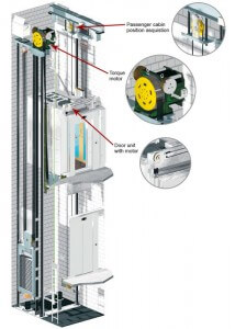

EL_C_lg
Modern elevator design with the three possible applications for encoders:
– Passenger cabin position acquisition
– Torque motor
– Door unit with motor
