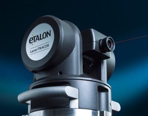

Was specially designed to increase the accuracy of machine tools and coordinate measuring machines: LaserTracer-NG from Etalon
The measurement equipment manufacturer Etalon provided the answer: The German company has developed a self-tracking laser interferometer specially dedicated to increasing the accuracy of machine tools by means of volumetric compensation. With Etalon’s technology, it is possible to calculate exact compensation values for spatial errors in all degrees of freedom. With micrometer accuracy, the system analyzes position errors, straightness errors, rotation errors (pitch, yaw and roll), and squareness between the axes in the whole working volume of the machine tool. Angular positioning deviations, axial and radial movements, and wobbling of the rotational axes are comprehensively recorded as well. Thus, the LaserTracer-NG fundamentally differs from conventional laser interferometers that involve elaborate aligning and generate a large amount of work for determining pitch, yaw and roll.

The LaserTracer-NG is a high resolution interferometer that automatically follows a reflector continuously measuring the distance to it. The system features an unprecedented accuracy of the center of rotation, which is realized by means of a reflective sphere with a form uncertainty of less than 0.1 μm. The patented beam guide makes sure that this sphere can serve as reference for the interferometric displacement measurement which is therefore conducted with highest dimensional precision to the tool center point (TCP). Consequently, mechanical deviations of the rotation and swivel axes are also acquired with very high precision. Measuring uncertainty for spatial displacement (95%) amounts to 0.2 µm + 0.3 µm/m.

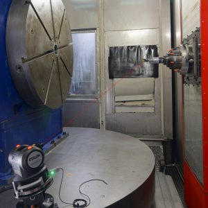

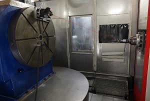

For conducting the measurement, Stephan Kunath places the compact LaserTracer-NG in the machine volume several times without any particular fine-alignment. Instead of a tool, the reflector is clamped in the spindle. Then, the measurement system is ready to start the automated measurement process: It tracks the actual path of the machine in its entire working space. The required NC programs are automatically generated by Etalon’s software, and the respective distances to the tool center point are determined interferometrically. Etalon’s system transfers the recorded measured data to the connected Trac-Cal measuring software, which automatically analyses the measured data and transfers the volumetric compensation values to HEIDENHAIN’s iTNC 530 controller via KinematicsComp.
Rotation axis calibration of a large machine tool with axes travels of 2.5 x 2.3 x 0.8 m³. The LaserTracer-NG—mounted on a rotary table with a diameter of 1.2 m—is positioned stationary in the machine several times.
