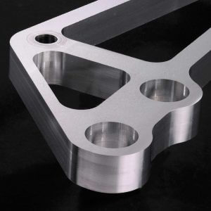

Clearly visible after the second machining: The deviation of 70 µm due to the thermal expansion of the ball screw drive.

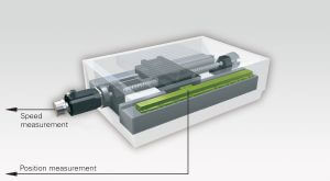

Unaffected by the temperature development on the ball screw drive: Closed loop position measurement with a linear encoder

Invisible second drilling with closed loop control: A twice machined part with no corners and edges.
Everything under control with precise position measurement
On the other hand, position measurement with a linear encoder is independent of the thermal expansion of the ball screw drive—and any other influences. This so-called closed loop control always determines the precise position of the machine table. The result is stable production with a constantly high level of workpiece quality.
A comparative machining run demonstrates the example described above. There is no scrap from a machine with closed loop control; all the parts are within the specified tolerance. A second machining run, with the first part after machining of the 40th part with half the feed setting in Z direction, leaves no visible edge.
