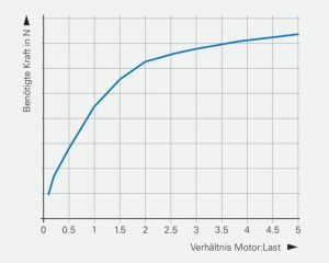

Figure 1: Necessary load reversal for a given position error as a factor of the inertia ratio between the motor and the load
A system’s rigidity is a crucial factor in its resilience to vibrations or milling forces—the greater the rigidity, the better. Rigidity, in turn, is heavily influenced by the inertia ratio between the motor and the moving mass of the feed axis (load). This means that larger motors provide greater system rigidity against milling forces or vibrations. Figure 1 shows, as a function of the inertia ratio between the motor and the load, how high a sudden load reversal must be in order to temporarily cause a given position error in a drive.
By way of illustration, a lightweight trailer attached to a large, high-torque vehicle will introduce fewer disturbances into the entire system when exposed to wind gusts or road damage than will a heavy trailer pulled by a lightweight vehicle of the same torque. This is true even though the lighter trailer is obviously much more susceptible to these influences than the heavier one. For a machine tool, this means that the largest possible motor should be moving the lightest possible table in order to minimize the effect of disturbances on the entire system (such as milling forces or vibrations arising at the table).
Unfortunately, if there is a significant difference between the inertias of the motor and the load, it is also necessary to lower the loop gains. Lowering the loop gains leads to lower rigidity, meaning that the entire system reacts more strongly to load disturbances, e.g., from milling forces or vibrations.
For a machine tool, a balanced inertia ratio between the motor and the load should therefore be selected. A balanced ratio provides the amount of rigidity needed to make the entire system insusceptible to external influences exerted on the load, meaning that these influences have no effect on the machining result, and, at the same time, making it possible to work with high loop gains. In other words, the trailer and the vehicle pulling it should be correctly matched to each other.

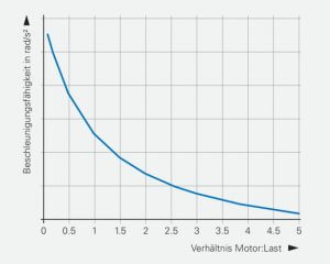

Figure 2: The acceleration capability of a motor as a factor of the inertia ratio between the motor and the load
The right dynamics
A motor design featuring the highest possible moment of inertia would contradict the next requirement, namely the highest possible acceleration capability. This is because the motor’s own inertia has a significant influence on the acceleration capability of the entire system. A direct correlation can be demonstrated using the formula for calculating the acceleration capability as seen in Figure 2: ω ̇=M_max/((J_load+J_motor ) )
For a given maximum torque of the motor Mmax and a given load inertia Jload, the acceleration capability of the entire system ω ̇ becomes smaller as the inertia of the motor Jmotor increases. Simply stated, this implies that a motor with low inertia achieves rapid acceleration—the more inertia a motor has, the more torque it must produce in order to accelerate the load as desired.
Figure 3: Test setup – Machining an oblique surface using differing motor designs for the Z axis
When it comes to the amount of torque needed, economic viability becomes a factor as well, because the higher the maximum torque required, the more expensive the motor becomes. This is due to the fact that higher performance requires more or better magnetic materials for larger or optimized motors. Thus, both acceleration behavior and cost considerations make a case for a ratio between the motor and the load that is balanced and well-adapted to the intended application.

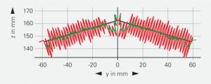

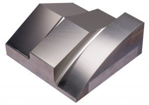

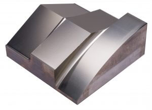

For the comparative measurements used in analyzing the torque ripple of various motor designs, the Z axis of the same machine tool under exactly the same test conditions was first moved by a HEIDENHAIN axis motor made for the machine tool and then by an axis motor taken from the automation industry and not specifically designed for the machine tool but rather merely adapted to the particular application. A machining operation was performed to mill an oblique surface on a sample workpiece. During face milling, the Z axis was moved at a feed rate of F = 6,250 mm/min for 60 mm in the Y direction and for 17.5 mm in the Z direction.
These tests confirm the anticipated effect of the torque ripple—not just by means of the contour error measurement data (the difference between the desired contour and the contour actually milled, Fig. 4) but also through the visible effects on the sample workpiece surface. The HEIDENHAIN axis motor that had been optimized for the machine tool features a low torque ripple and generates an evenly angled surface without visible shadings (Fig. 5). With the axis motor that had been taken from the automation industry and adapted to the machine tool, the effects of the torque ripple are clearly visible in the form of shadings on the oblique surfaces (Fig. 6).
Figure 6: Workpiece with clearly visible shadings on the oblique surface after machining with a motor merely adapted to the machine tool.
Figure 4: The contour errors measured for the machining samples: HEIDENHAIN axis motor with low torque ripple (green line) and the adapted motor with considerably higher deviations (red line)—Magnification factor of the contour errors: 1000 .
Figure 5: The HEIDENHAIN motor designed specifically for the machine tool produced an evenly angled surface without visible shadings.
Expressed in measured values, the HEIDENHAIN axis motor achieved an effective contour error of just 0,2 µm at the level of visually discernible deviations. By contrast, the effective deviation of the axis motor adapted to the machine tool came in at 1,2 µm, which is greater by a factor of five.
