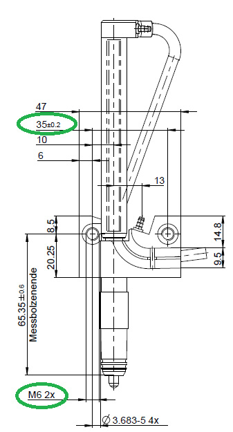

Figure 2: Fastening to a plane surface

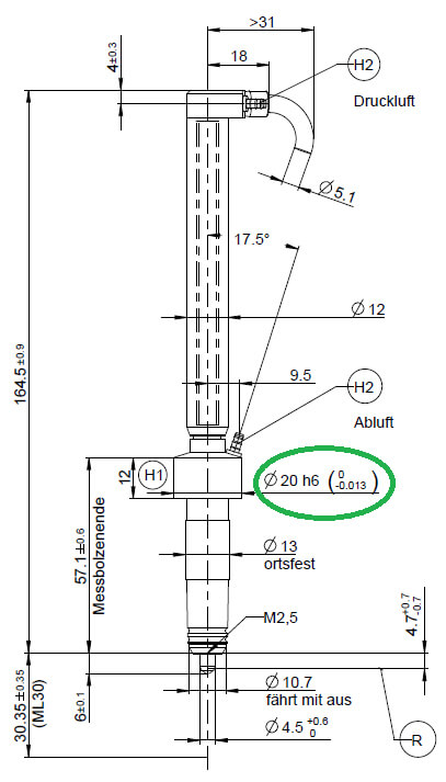

Figure 3: Fastening to a clamping shank
In the retracted rest position, the housing and splash guard protect the bellows. During the measurement (coolants are normally switched off at this time), the plunger is extended by pressurized air. The length gauge features two connections for pressure tubing. Just as in the standard version, the connection for actuating the plunger (Figure 1, green arrow) is at the cable outlet. When the cap closes the housing, it collects pressurized air which is released by a further connection at the base (Figure 1, red arrow). This tube must be located at a contamination-free area of the machine to prevent ingress of contamination into the device.
Two methods were developed for attaching the length gauge. The intention was to ensure compatibility with the screw connection of the MT 25PW and offer an alternative for new confined space conditions. The illustrations on this page show two possibilities for fastening the length gauge. Figure 2 shows the screw connection with the clearance and thread diameter encircled. Figure 3 shows connection with a mounting shaft.
