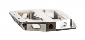

The finished workpiece: a bicycle pedal for downhill bikes
