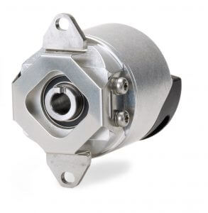

For safety-related applications: ECN 1123 and EQN 1135 absolute rotary encoders from HEIDENHAIN with mechanical fault exclusion
The ECN 1123 and EQN 1135 absolute rotary encoder versions with functional safety were designed by HEIDENHAIN specifically for safety-related applications in the medical technology industry. These encoders are certified for safety-related applications in conformity with SIL 2 (EN 61508) or Category 3, Performance Level d (EN ISO 13849). They also feature mechanical fault exclusion. Their positive-locking hollow shaft features a special positive locking element that securely locks into a corresponding groove in the drive shaft during the mounting process and very effectively prevents slippage in the shaft connection.
Both rotary encoders provide absolute position values: the ECN 1123 with a singleturn resolution of 23 bits, and the EQN 1135 with an additional multiturn resolution of 12 bits. Data is transferred over the purely serial, bidirectional EnDat 2.2 interface. In their functional safety versions, the rotary encoders provide two independently generated position values over this EnDat interface. The PFHD value, which represents the probability of dangerous failure per hour and is required for the evaluation of safety systems, lies below 15 x 10–9 for these rotary encoders.
Thanks to a housing diameter of only 35 mm, the ECN 1123 and EQN 1135 rotary encoders are particularly well-suited for applications with low installation space, such as on small servo motors with a flange size of 40 mm, as are common in the medical technology industry. Also fitting for this type of application and integrated into the encoders’ electronics is the capability of evaluating a temperature sensor in the motor winding. The EnDat protocol transmits the digitized temperature value purely serially, thereby reducing the number of wires in the cable by two.
