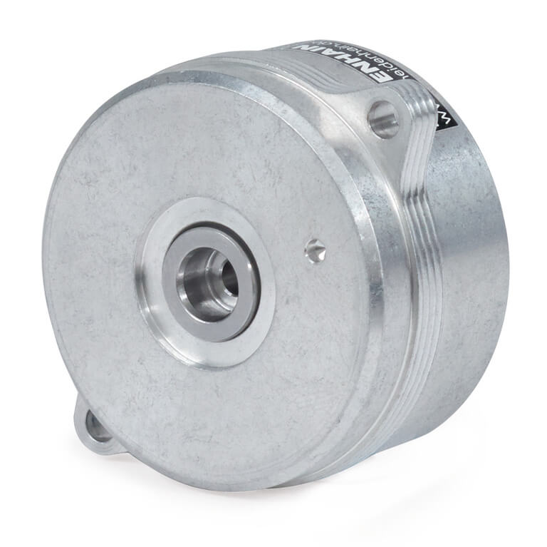

Encoders and resolvers essentially do the same thing: measure rotary motion and speed, but in different ways. How they integrate into a system and the format of the feedback are where key differences arise—aside from the fact that there is another type of encoder made to measure linear movement. For example, while resolvers are similar to motors in terms of form, they must be delicately tuned and often feedback formats need to be converted to pair with the control computer. Encoders are more flexible, providing clear digital signals and adapting easily to various sizes and future upgrades.
Put another way, resolvers can only replace encoders if the input device can accept resolver sine/cosine signals and the hardware fits together. Encoders can almost always take the place of a resolver, especially in modern applications where controls are digital. Let’s take a deeper look at some of the similarities and differences between encoders and resolvers.

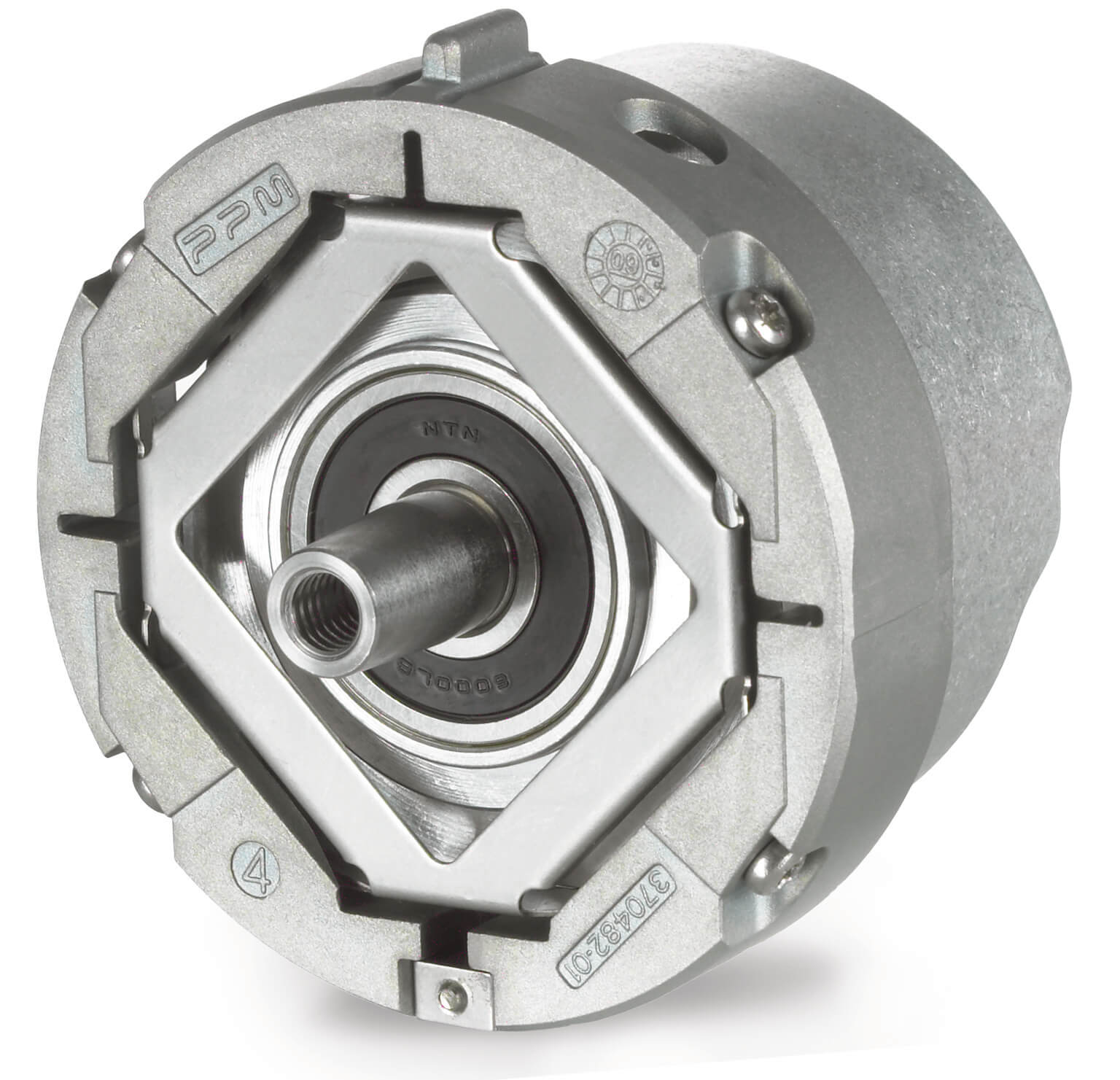

When an encoder is used in a control system, there are only two issues to consider: desired resolution and the maximum rpm the encoder will need to work at. There are also no encoder dynamics to deal with as the measurement process is fundamentally digital. An encoder provides data with guaranteed signal separation and symmetry at up to the rated speed. Many encoders are now available with resolutions up to 25 bits, and some are capable of allowing the motors to run at 10,000 rpm with close to this resolution. As a result, an encoder-based application will generally have a wider dynamic range capability.
Data Format
Resolvers are “absolute” measurement systems. They provide a unique Sin/Cos voltage at every point in a 360-degree rotation.
An encoder can be absolute or incremental, and the output will be digital. Absolute encoders usually have a serial data bus, with which the drive must be able to communicate in order to read out the position measurement. This requires the designer to verify that the encoder and the drive are compatible. Incremental encoders are ubiquitous and every drive made can interface with them.
Accuracy
An encoder will be more accurate than a resolver and its associated conversion process.
Flexibility
If at some point in the future more performance or positioning accuracy becomes necessary, it will be much easier to upgrade an encoder-based system. An encoder application will require only the feedback element to be replaced, and a software change to the drive so that the new line count is accounted for. A resolver change will require reconsideration of the associated converter, supply voltage and frequency, filtering, etc., and this may not be possible to change unless the drive has been developed with this in mind.
