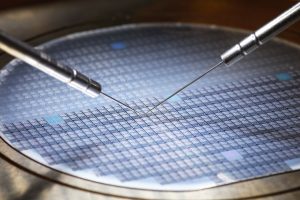

Added complexities require closer inspection![ETEL controls that can calculate the best path-performance for inspection](https://www.heidenhain.us/wp-content/uploads/2018/10/AdobeStock_179618172-1-300x200.jpeg)
Advances like fan-out wafer level packaging introduce variables to the production process and, in turn, a higher chance for imperfections in the end product. This too requires extreme speed and accuracy for efficient, profitable semiconductor manufacturing. Two specific solutions are proving invaluable in this process.
First are ETEL controls that can calculate the best path-performance for inspection and placement tools using algorithms—similar to those used to help race car drivers turn corners at high speeds. Second is the HEIDENHAIN LIP 6000 encoder; it’s necessarily small and has a signal stability of 0.4 nanometers at 1 MHz that gives a motion system millisecond-level seek and settle times.
