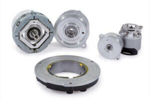

1. The Ability to Use Encoders
Rotary and angle encoders for servo drives provide detailed and precision feedback to the control with thousands of times higher resolution than what’s possible with stepper motors. Absolute and incremental-style encoders both not only allow for the precise control motion and speed that’s required of today’s multi-axis machinery and intricate part geometries, they provide operators with better visibility to how the operation is performing.
These encoders are easy to mount and wire, are short in overall length and can even account for safety functions like those handled by limit switches.
