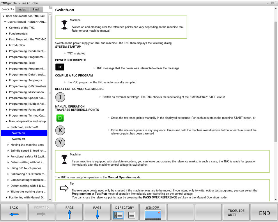

The TNCguide context-sensitive help system contains the user documentation in HTML format.
- The following user documentation is available in TNCguide:
- Conversational Programming User's Manual (BHBKlartext.chm)
- ISO User's Manual (BHBIso.chm)
- User's Manual for Setup, Testing and Running NC Programs (BHBoperate.chm)
- User’s Manual for Cycle Programming (BHBtchprobe.chm)
- List of All Error Messages (errors.chm)
In addition, the main.chm "book" file is available, with the contents of all existing .chm files.
Machine
As an option, your machine tool builder can embed machine-specific documentation in the TNCguide. These documents then appear as a separate book in the main.chm file.
Procedure
Call TNCguide in the following ways:
- Press the HELP key during program input
- Click the help symbol with the mouse and click the desired soft key
- Press the HELP key and search for a term
- Open a chm file in the file management
Tip
The control always tries to start TNCguide in the language that you have selected as the conversational language on your control. If the files with this language are not yet available on your control, the control automatically opens the English version.
