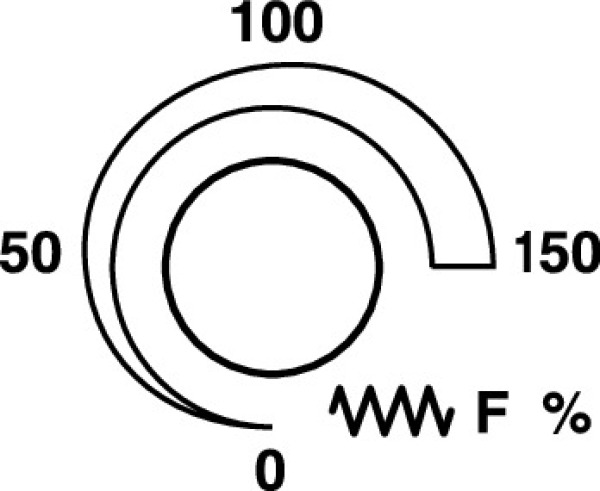

Potentiometers
Feed rate | Spindle speed |
