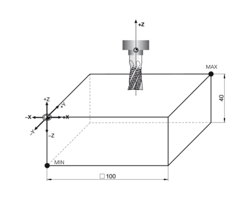

The sides of the cuboid lie parallel to the X, Y and Z axes. This blank is defined by two of its corner points:
- MIN point: the smallest X, Y, and Z coordinates of the cuboid blank; enter as absolute values
- MAX point: the largest X, Y, and Z coordinates of the cuboid blank; enter as absolute or incremental values
Tip
Describe the blank with respect to the active preset.
The MIN point defines the blank on the left (X), front (Y) and bottom (Z).
The MAX point defines the blank on the right (X), at the rear (Y) and top (Z).
To define the BLK FORM workpiece blank, proceed as follows: | ||
BLK FORM 0.1 Z X+0 Y+0 Z-40 | Spindle axis and minimum point |
BLK FORM 0.2 X+100 Y+100 Z+0 | Maximum point |

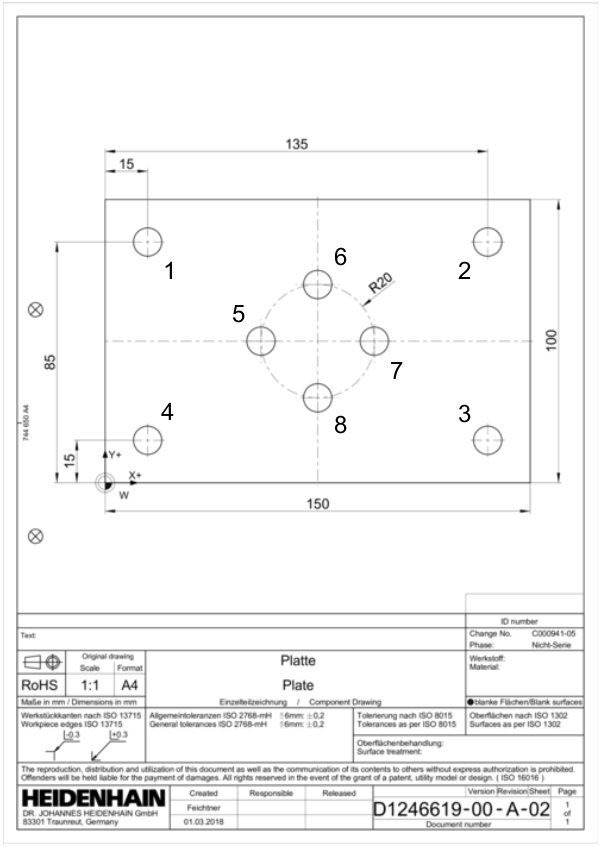

Milling | X | Y | Z |
Safe position | +150 | +150 | +100 |
Safety clearance | - | - | +5 |
Pre-position | -60 | +35 | +100 |
Ø | T | S | F1 | F2 | DZ | IZ | |
![]() | 10 | 5 | 8900 | 1100 | 2000 | -5 | 5 |
Ø) | Diameter |
T) | Tool number |
S) | Speed |
F1) | Machining feed |
F2) | Retraction feed rate |
DZ) | Max. machining depth |
IZ) | Infeed |
